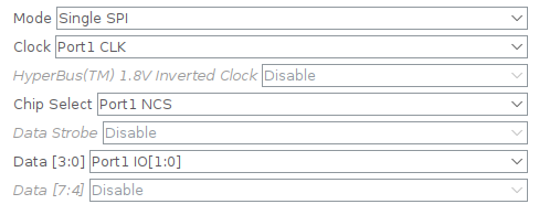

I'm trying to configure the OCTOSPI1 bus as Single-SPI to read the status register of an external memory (MRAM).

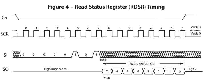

What I expect to see on the scope
What I really see:
Please, find below more details about the setup and code (ask me for more detais if needed):

OCTOSPI Init
static void MX_OCTOSPI1_Init(void)
OSPIM_CfgTypeDef sOspiManagerCfg = {0};
hospi1.Instance = OCTOSPI1;
hospi1.Init.FifoThreshold = 1;
hospi1.Init.DualQuad = HAL_OSPI_DUALQUAD_DISABLE;
hospi1.Init.MemoryType = HAL_OSPI_MEMTYPE_MICRON;
hospi1.Init.DeviceSize = 19; // 512 KB
hospi1.Init.ChipSelectHighTime = 1;
hospi1.Init.FreeRunningClock = HAL_OSPI_FREERUNCLK_DISABLE;
hospi1.Init.ClockMode = HAL_OSPI_CLOCK_MODE_0;
hospi1.Init.WrapSize = HAL_OSPI_WRAP_NOT_SUPPORTED;
hospi1.Init.ClockPrescaler = 4; // 129/(4+1) = 25,8 MHz < 40 MHz
hospi1.Init.SampleShifting = HAL_OSPI_SAMPLE_SHIFTING_NONE;
hospi1.Init.DelayHoldQuarterCycle = HAL_OSPI_DHQC_DISABLE;
hospi1.Init.ChipSelectBoundary = 1;
hospi1.Init.ClkChipSelectHighTime = 0;
hospi1.Init.DelayBlockBypass = HAL_OSPI_DELAY_BLOCK_BYPASSED;
hospi1.Init.MaxTran = 0;
hospi1.Init.Refresh = 0;
if (HAL_OSPI_Init(&hospi1) != HAL_OK)
Error_Handler();
sOspiManagerCfg.ClkPort = 1;
sOspiManagerCfg.NCSPort = 1;
sOspiManagerCfg.IOLowPort = HAL_OSPIM_IOPORT_1_LOW;
if (HAL_OSPIM_Config(&hospi1, &sOspiManagerCfg, HAL_OSPI_TIMEOUT_DEFAULT_VALUE) != HAL_OK)
Error_Handler();

}Read Status register (the code is executed without errors but reads a sr = 0xFF).
OSPI_RegularCmdTypeDef cmd = {
.OperationType = HAL_OSPI_OPTYPE_COMMON_CFG,
.FlashId = HAL_OSPI_FLASH_ID_1,
/// Instruction phase
.Instruction = CMD_RDSR,
.InstructionMode = HAL_OSPI_INSTRUCTION_1_LINE, // 1-bit at a time
.InstructionSize = HAL_OSPI_INSTRUCTION_8_BITS,
.InstructionDtrMode = HAL_OSPI_INSTRUCTION_DTR_DISABLE, // Double transfer rate
// Address phase
.AddressMode = HAL_OSPI_ADDRESS_NONE, ///< None => Phase is skipped
// Alternate-bytes phase
.AlternateBytesMode = HAL_OSPI_ALTERNATE_BYTES_NONE, ///< None => Phase is skipped
// Dummy-cycle phase
.DummyCycles = 0, /// 0 => skipped
// Data phase
.DataMode = HAL_OSPI_DATA_1_LINE, // 1 bit at a time
.NbData = 1, // Number of bytes to read/write
.DataDtrMode = HAL_OSPI_DATA_DTR_DISABLE, // Double transfer rate
.DQSMode = HAL_OSPI_DQS_DISABLE, // Data sttrobing not used
.SIOOMode = HAL_OSPI_SIOO_INST_EVERY_CMD
if (
HAL_OSPI_Command(
&hospi1,
&cmd,
) != HAL_OK
Error_Handler();
if (
HAL_OSPI_Receive(
&hospi1,
sr,
) != HAL_OK
Error_Handler();
}Thank you for your time.
