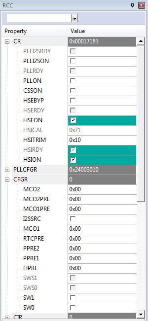

CMSIS startup turn on the HSI, and HSE. After timeout (because plate don't have HSE, and flag HSE RDY not set) SYSCLK switch to HSI directly.
I need the timer clk not lower 50 MHz, therefore i need the SYSCLK from PLLIn first screenshot - RCC regs after startup: HSI on, HSI ready, HSE on, HSE not ready, PLL off. SW bits - 00 (SYSCLK is HSI)2014-08-31 4:02 AM

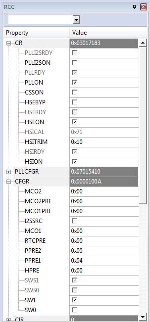

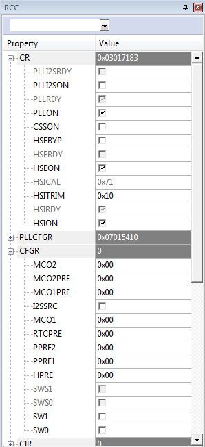

Flash latency after startup set to 0
If I change this to one wait state all be work.Thank you2014-08-31 11:08 AM
I'd think at 84 MHz you'd want 2 wait states (3 cycles) for the flash access to meet specifications.
