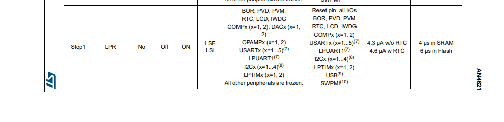

2021-07-02 4:10 AM
I am using following datasheet:
I am using STOP1 mode.

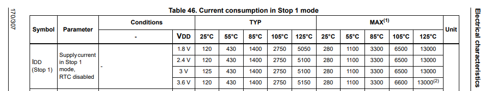

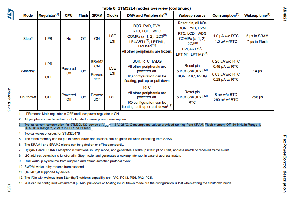

The table of the application note you are referring to concerns the L4 product while you are working with the L4+, please check the note I highlighted in the screenshot below:
To check the correct values of the power consumption I advise you to refer to the datasheet of STM32L4R5xx since it contains different use cases presented in the table 46.
