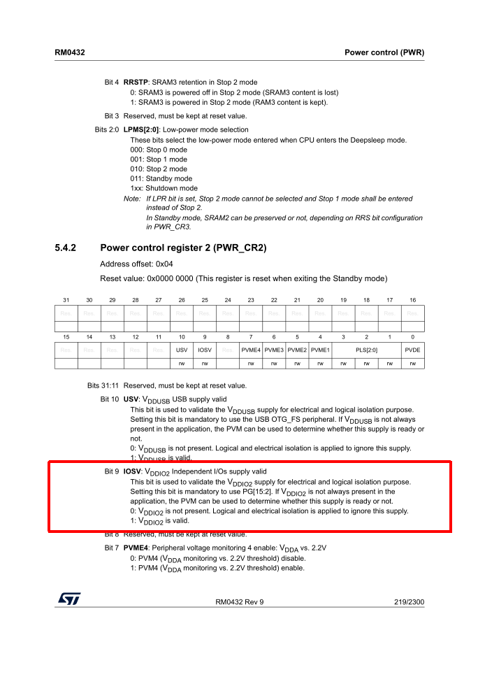

PG2 to PG15 pins are supplied not from VDD but from VDDIO2, and you have to switch the VDDIO2 domain on by setting PWR_CR2.IOSV
2023-03-26 12:05 PM
Thanks for help. This issue is solved by calling "HAL_PWREx_EnableVddIO2();"
as JW pointed out "PG2 to PG15 pins are supplied not from VDD but from VDDIO2, and you have to switch the VDDIO2 domain on by setting PWR_CR2.IOSV"
