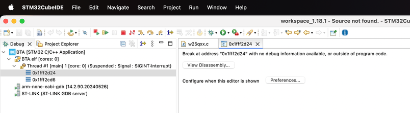

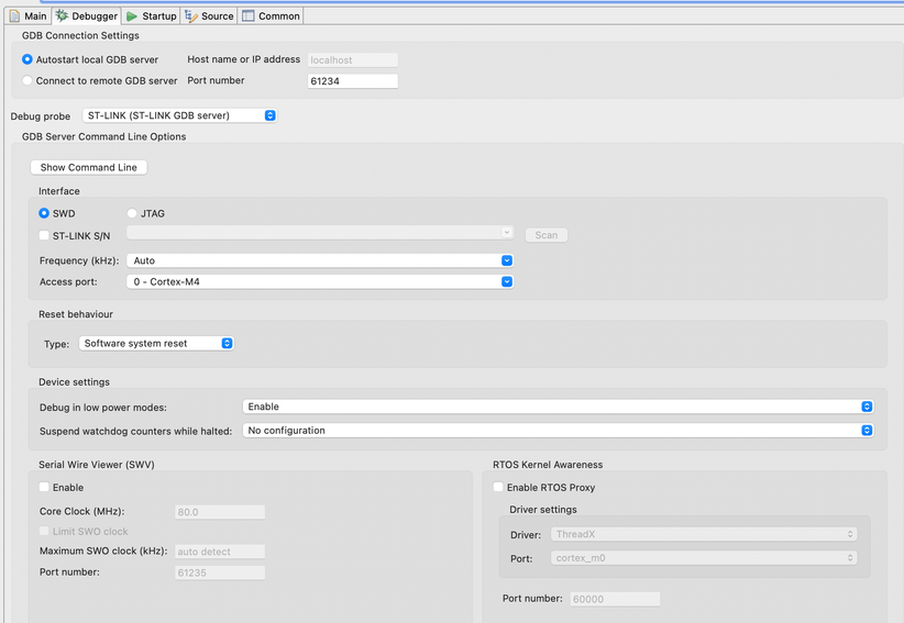

I am developing software on the Nucleo-L433RC-P board but have a strange situation when debugging.
The first time I debug, the software does not run and I get the following error...
Break at address "0x1fff2ce8" with no debug information available, or outside of program code.
Break at address "0x1fff2cd6" with no debug information available, or outside of program code.
As shown in the screenshot below...
However, the second time I debug it works correctly.
Why does it not work correctly on the first debug, but then works correctly on the second debug ?
I have tried two different boards (one of which is brand new and never been used) but the behaviour is the same, so it must be a software issue.

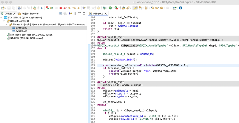

It fails on line 168 of the 'w25qxx_init' function and then the debugger crashes. When I pause the debugger it appears to go outside the flash area with the error "Break at address "0x1fff2d24" with no debug information available, or outside of program code."
I did not write the w25qxx driver, I got the driver from here...
https://github.com/mengguang/w25qxx
I do not understand what this line is doing anyway....
char *version_buffer = malloc(strlen(W25QXX_VERSION) + 1);
Its strange how it also happens alternately
First debug flash and it fails, second debug flash and it works and so on....

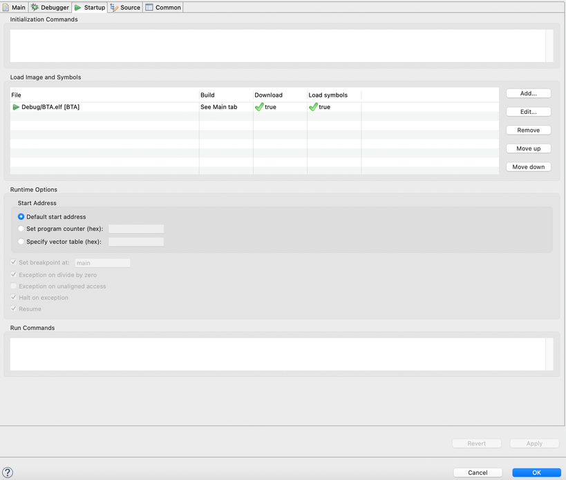

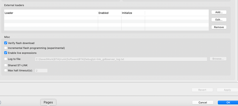

Thanks all, how do I enable Full Chip Erase and ensure my debug configuration includes program loading before starting execution ?
I cant see any options for those in the debugger settings ?

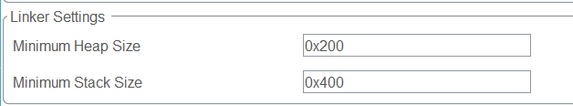

The stack size is the default setting, I have not changed this...
_Min_Heap_Size = 0x200; /* required amount of heap */
_Min_Stack_Size = 0x400; /* required amount of stack */I have never used stack painting so will need to look further into this.

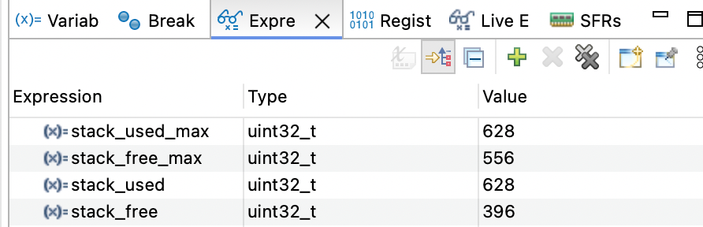

I checked the stack and its well within the limits....
Below is the code snipet to check the stack...
static uint32_t stack_used;
static uint32_t stack_free;
static uint32_t stack_used_max;
static uint32_t stack_free_max;
int main(void)
HAL_Init();
SystemClock_Config();
Stack_Paint();
void Stack_Paint(void) {
uint32_t *p = &_stack_end;
while (p < &_estack) {
*p++ = 0xA5A5A5A5; // fill with pattern
uint32_t Stack_GetUsage(void) {
extern uint32_t _stack_end;
extern uint32_t _estack;
while (p < &_estack && *p == 0xA5A5A5A5) {
p++;
stack_used = (&_estack - p) * sizeof(uint32_t); // bytes used
if (stack_used > stack_used_max)
stack_used_max = stack_used;
uint32_t Stack_GetFree(void) {
p++;
stack_free = (p - &_stack_end) * sizeof(uint32_t); // free space in bytes
if (stack_free > stack_free_max)
stack_free_max = stack_used;
Stack_GetUsage and Stack_GetFree is called in a 100ms task and the program is left to run for several minutes.
