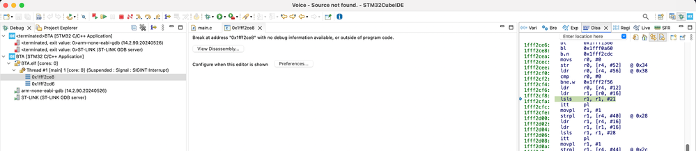

I am developing software on the Nucleo-L433RC-P board but have a strange situation when debugging.
The first time I debug, the software does not run and I get the following error...
Break at address "0x1fff2ce8" with no debug information available, or outside of program code.
Break at address "0x1fff2cd6" with no debug information available, or outside of program code.
As shown in the screenshot below...
However, the second time I debug it works correctly.
Why does it not work correctly on the first debug, but then works correctly on the second debug ?
I have tried two different boards (one of which is brand new and never been used) but the behaviour is the same, so it must be a software issue.

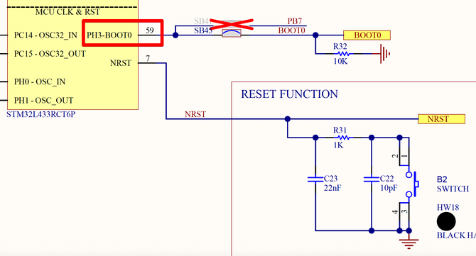

That's from the ROM, so either the BOOT0 is HIGH, or the FLASH is blank and doesn't contain viable vector table, so goes to ROM code instead.
2025-07-16 2:03 PM - edited 2025-07-16 2:11 PM
BOOT0 is pulled low via a 10k resistor on this board and the pin on the header is floating
why would the flash be blank when I debug ?

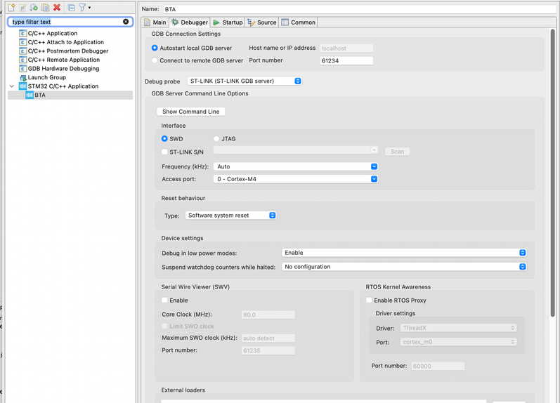

2025-07-16 2:18 PM
I've tried "Software system reset" and "Connect under reset" options, but it made no difference.
