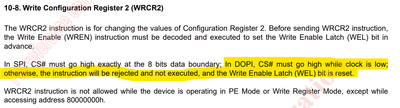

When I referred memory datasheet for WRCR2 command details, it says #CS should go high when clock is low while in SPI mode #CS should go lo at 8 bits boundary. Can you please guide on how can we have a control on #CS going high when clock is low?
Is there anything that I might be missing on for DTR OPI mode? Please suggest. Let me know if you require any more configuration details.
