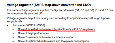

Hello @junwon0425 and welcome to the community,
NUCLEO-H755ZI-Q board is configured in SMPS mode (by default) not in LDO mode. Unless you modified the board to support the LDO mode.
I'm wondering how you could run your example even at 400Mhz. That doesn't make sense.
Moreover, you can't select a system frequency > 400MHz if you are in SMPS configuration.
From the datasheet:
Boosted mode (> 400Mhz at VOS0) is available only with LDO configuration (which is not the case with the default configuration of the NUCLEO-H755ZI-Q board):
