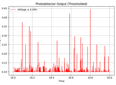

@sreyas40 wrote:
yes i need exact peak voltage.
There is no fixed difference between peaks.
I don't think a comparator will be useful?
No, not a comparator but peak detector with reset circuits. If pulses arrive not very often, than you don't need fast adc

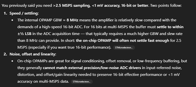

@sreyas40 wrote:It's not an option, buffering adc inputs with op-amp is must - what are the parameters i should look out for when selecting a buffer op-amp.
This thread mentions ad7960, ad7983/ 84 - get data sheet and study drivers. Analog (ADI Corp.) also has evaluation boards for this adc, worse to look into.
In general, high speed, wide bandwidth and low distortion, most of this op amp intended for video application. Front page of the data sheet such op amp explicitly says "application: Precision SAR ADC drivers, or just ADC drivers".
In STM particular case, I'd recommend to use lmh6612.
3.3V limits pretty tough requirements in this domain, ada4899 and a lot others op amp are not good due +5-+12 V power range.
@sreyas40 wrote:Is there any case/situation when buffering of adc input is not needed
Only if output impedance of the signal source is low and constant, like resistive bridges, inductive sensors (dynamic mics etc), resistive current shunts or current transformers.
Photodetectors are high output impedance category devices and demand TIA at least.
