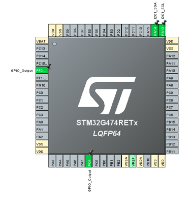

Hello everyone, I am trying to make an I2C communication with the Nucleo G474RE, however I am having problems at the time of Debugging. This is causing that the SCL stops working on my board.
I use the I2C1 Pin 14 (PA14) and Pin 13 (PA13) in the initial configurations.
Then I try to check if the GPIO of Pins 14 and 15 performs any reaction through the HAL_GPIO Toggle_Pin() function, and I come to the conclusion that the SCL pin (Pin 14 /PA14) no longer reacts.
I understand that at the moment of doing the Debug these pins correspond to SYS_JTMS-SWDIO (PA13) and SYS_JTCK-SWCLK (PA14) so there is a conflict there.
How can I solve this problem? that would be the first question, the second one would be if my board is not working properly?
Thanks

Thank you very much for your reply. My other question would be, if it is possible that my board was damaged? because of the bad execution of Debug having used these pins SWDIO and SWDCLK initially as I2C1, because I have noticed through Scope that the SDA signal is no longer visible to any alternate I2C that the Board has. For example for I2C2.
I have made a simple program to know if the GPIOs are working correctly using the HAL_GPIO_TogglePin() function, and I have noticed that some GPIOs are not reacting correctly, for example PF0 (SDA I2C2) does not give any Output.
Is there any way to save this board? or to make it work normally again?
