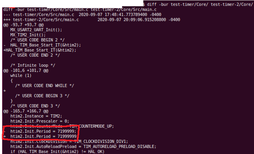

2020-09-08 11:14 AM
2020-09-08 11:17 AM
2020-09-08 11:18 AM
2020-09-08 12:38 PM
Your timer period differs by a factor of 10 between the projects.
2020-09-08 12:46 PM
that's because I saved them at different times. I usually play with various numbers to see if the boards react correctly.
but I can confirm that the 71,999,999 values does give me a 1s toggle on the test-timer-2, changing it to 7,199,999 gives me a 0.1s toggle, as expected.
however, on the test-timer project, changing the value has no impact whatsoever, it always remain the same, roughly 0.2s toggles.
2020-09-08 12:56 PM
I just tried changing the value (Period) in code rather than cubeMX and it went through.
the value you see at 7,199,999 was not getting regenerated when changing the value in CubeMX.
well that fixed it! thank you.

2020-09-08 1:00 PM
Okay. You said the projects were identical. They weren't, and the difference would absolutely describe what you're seeing.
It does not make sense that the value in "htim2.Init.Period" has no effect on the program. The only way that could be true is if you're not compiling/running the code that you think you are.
