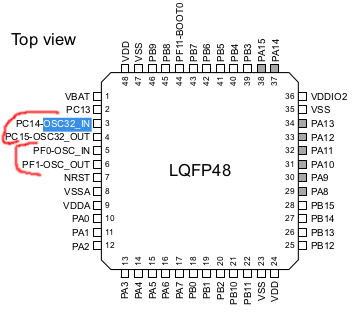

Thank you, Clive. What confuses me is that the 32-pin package has only one set of of OSC_IN/OSC_OUT pins, while other packages have dedicated OSC32_IN/OSC32_OUT pins for 32kHz low-speed crystals. I want to make sure I'm connecting the right oscillator to the right pins :=)
Does the 32-pn package not support a 32kHz crystal, or can you configure the same pins to accept either kHz or MHz crystals?

Perhaps something best discussed with an FAE.
I'm using a 32-pin L4, and here PA0 is CK_IN, and tests there indicate it is not bonded to the OSC_IN pin, but is more architectural.
Given the relatively low cost of the NUCLEO this is the sort of thing I'd test in real-life before committing to a design.
