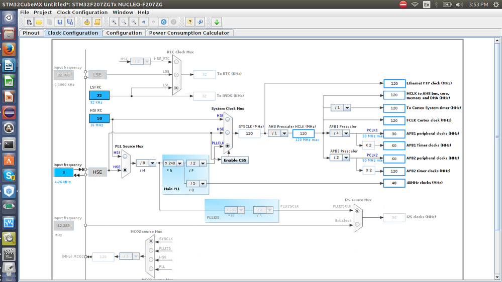

Hi, I am using STM32CubeMX for generating code and using SW4STM32 IDE.
I have configured cubeMX for CDC and generated an initialization code.
In that I have called CDC_Receive_FS(),CDC_Transmit_FS() functions as below.

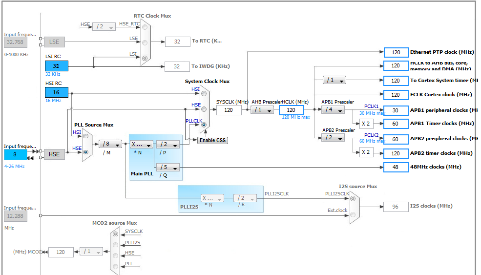

Yes.I have increased heap and stack sizes..when HCLK is 120 MHz it is not working ,but when I am using HSI for sys and HCLK then it is working

I tried the same but NO it isn't working for me...It doesn't pass SystemClock_Config(),Is there any jumper setting I have to do?
