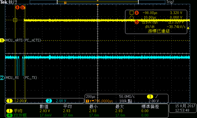

2017-08-15 11:41 PM
Dear Danish,
Yes, It is correct, I didn't read the USART1->RDR, but I open the
View->System Viewer-> USART->USART 1 window
that update the USART1->RDR which make a read operation on USART1->RDR and it changes the RXNE to low.thanks for your helps,
Test 1 and Test 2 are illustration for the impact of USART1 viewer window.
Thanks and regards,
E-John
Test1. View->System Viewer-> USART->USART 1 is NOT open in Keil debugger tool, USART1->RDR is not read in code.
Test 1 Result:
after sending a ASCII character on RealTerm application, the nRTS goes high which told PC it is NOT available to receive data because data is NOT read from USART1->RDR.

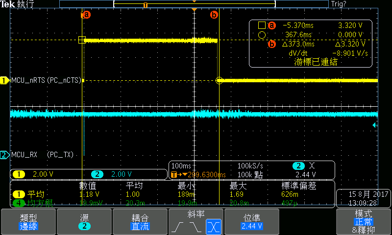

Test2. View->System Viewer-> USART->USART 1 is open in Keil debugger tool, USART1->RDR is not read in code.
Test 2 Result:
after sending a ASCII character on RealTerm application, the nRTS goes high then back to low because data is read from USART1->RDR by
