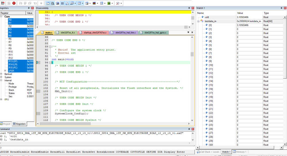

On my custom designed PCB, there is a STM32F7 processor. With SPI DMA interface, I try to get the converting values of the external ADC. But everytime I get 3.1V in debug session. So how can I read the correct values based on the input signal?

}2019-12-19 3:37 PM

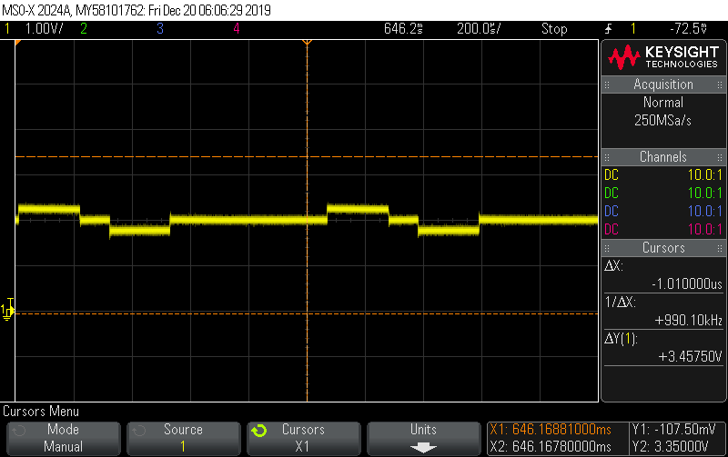

Check data on SPI with scope/analyzer, and try non-DMA operation.

You should focus on the signal on the wire, what the CS, DATA and CLOCK pins are doing, and if the data you can establish there is consistent, or not, with the data you're getting into memory. A logic analyzer may decode or display this.
Then review that in light of your SPI configurations, and the expectations of the external ADC.
