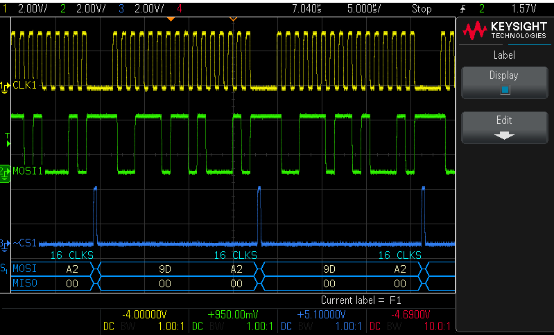

I am learning bare-metal programming on STM32F411RE (Nucleo board). I am trying to implement a SPI driver.
Even though I have set the Data Frame Format to 8-bit, My SCK consists of 16 clock cycles. Sending 8 bit data on this has weird behavior(I am trying to send 0x9D below):
Here's my code:

void SPI_write(uint8_t data)
while(!(SPI1->SR & 0x2)); //till transmit buffer is NOT empty, do nothing.
SPI1->DR = data;
while(SPI1->SR & 0X80); //while BSY flag is 1 do nothing. ie wait till transmission is complete
}Sending 16 bit data, of-course, works perfectly (sending 0x9D and 0xA2 here):
My application requires me to send 24 bit data in a single ~CS cycle. So I can't use the 16-bit frame format. I need 8 bit frame format. Going through forum answers I found this answer trying to force the data register as:
*(__IO uint8_t *)&SPI->DR = data;
But even this doesn't work for me. I am still getting the 16 clock cycles on SCK. Any tips?

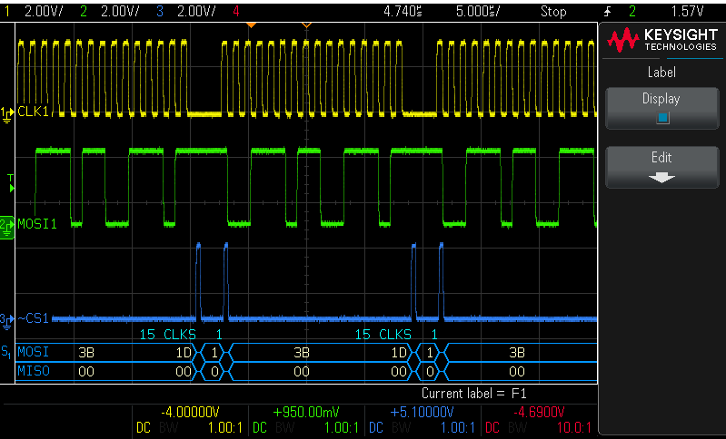

2020-02-23 12:39 AM
Note that the BSY bit is not set immediately when DR is written. Wait for TXE=1 first, then for BSY=0, and only then disable CS.
Casting to *(volatile uint8_t *)&SPI->DR might not even be necessary on the F4 series.

Thanks a ton! That simple change in code actually worked like a charm. :)
Should have read the instructions in RM carefully,my bad.
