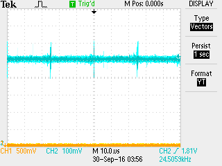

The noise we are seeing is spikes which is very periodic. The code below gives about a 25KHz rate of noise. The noise appears on all the ADC pins. The noise doesn't start appearing until the StartConversion call.If we don't use DMA and just use on-demand ADC almost all the noise is gone.Here is an image of what the noise looks like:volatile uint16_t RegularConvData[SAMPLES];

Does the same noise show up in the conversion data ?
If the noise source end up being not fixable, the problem should be easily overcome with oversampling and averaging, since the 5Hz sampling is significantly smaller than the 25KHz noise. Cheers, Hal2016-10-06 5:36 PM

Yes the noise shows up in the conversion data. The amplitude of the noise spikes varies so the amount of effect varies. We have tried doing a set of 16 samples from each input and using the average. That helps reduce the noise effect, but it is still big enough that our data isn't valid.If we turn off DMA and just do ''on-demand'' ADC, the noise is much less. We get one spike shortly after doing the ADC_StartOfConversion call.2016-10-10 8:48 AM

The noise may come from spurious charge shots out of AD inputs. Try to eliminate that with the using of ''Averaging'' or ''Digital-signal filtering'' methods described in the application note ''How to get the best ADC accuracy in STM32Fx Series and STM32L1 Series devices'' (page 22 and page 32)-Hannibal-We’re moving the ST Community to a new platform to give you a better and more reliable community experience.
