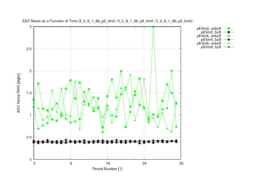

A picture is worth a thousand words. Four pictures are even better. To give you an idea of what you should possibly consider if you are facing A/D noise I browsed my old records.

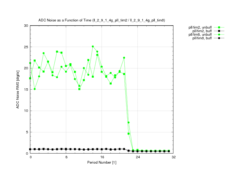

This is, where I started. The PL2303TA was bustling about up to period 22 to recover from the 1 MBaud / 32 KByte transmission of the most recent cycle. The RMS noise of the unbuffered (green) system went up to about 20 digits. Keep in mind that the noise of the perfect system is ? 0.29. Buffering (using the internal OpAmp) helped a lot. To investigate the data in the idle period of the PL2303TA, I zoomed the y-scale:

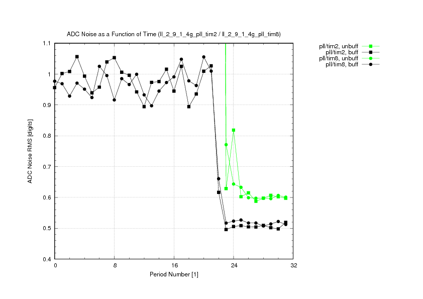

Same graph as above, just enlarged. After taming the interface (reducing the transmission speed to 19200 Baud), things look much better:

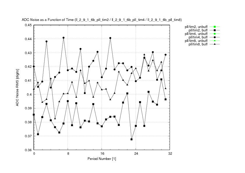

Now the buffered systems approach the theoretical limit of 0.29. Though the CPU was stopped, I required the timers for triggering the ADC. I tried TIM2, TIM4, and TIM8. The following is a zoomed plot for the buffered systems:
The graph suggests that the noise could depend on the timer. But to prove that, more measurements would be required. My application used TIM2.
