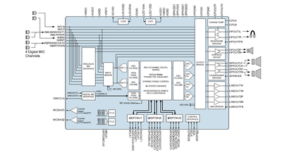

I am wondering if this is an issue with how the 35G-DK audio-input jack is connected. The schematic has the L/R inputs of the jack going to the LN and RN pins. Which apparently go through the analogue mic (PGA?) interface. I Wonder if this is the issue.

just from wm8994 data: >>
When mixing line inputs, input PGA outputs and DAC outputs the total signal must not exceed 1.0Vrms (0dBV).
A 1.0Vrms differential signal equates to 0.5Vrms/-6dBV per input. <<
so..what level you put in ? 0,5v is absolute maximum. try small level ; try set pga gain low.

ADC: I guess there is a setting to bypass the PGA, from the codec's pin naming it looks like IN1L/R can be used as standard line inputs.
