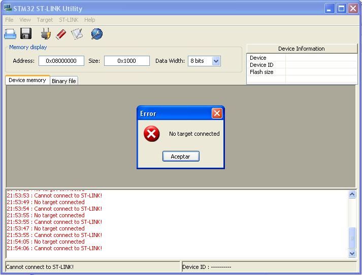

with the STM32 ST-LINK Utility also don't work. Where is my problem?2011-03-23 11:37 PM
Dunno, perhaps your ST-LINK is busted, try it on a different PC. If this is a VL discovery, do you still see the ''flash drive'' instantiation with the webpage/links to the documentation files when you plug it in. Does your account have administrative rights? Do you have some AV software that might interfere with normal operations?2011-03-24 4:50 AM

Bad News, after test with 3 STM32VLDISCOVERY and one ST-LINK in 3 differents PC's, the result is the same: ''NO STLINK Detected''. Now, I think that the problem maybe the Windows XP in Spanish. I will try to test in one PC with XP in english.
