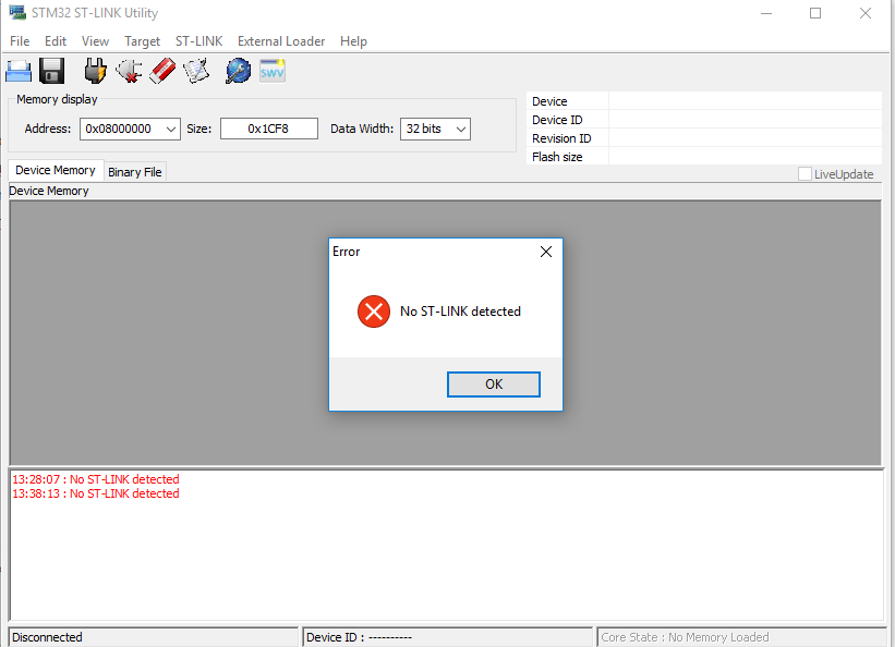

before this as well, and I had been able to connect to my board and flashing it with no problem. After attempting to get openocd to work though, this is no longer possible. Every time i try to connect to my board, I simply get the following error message:

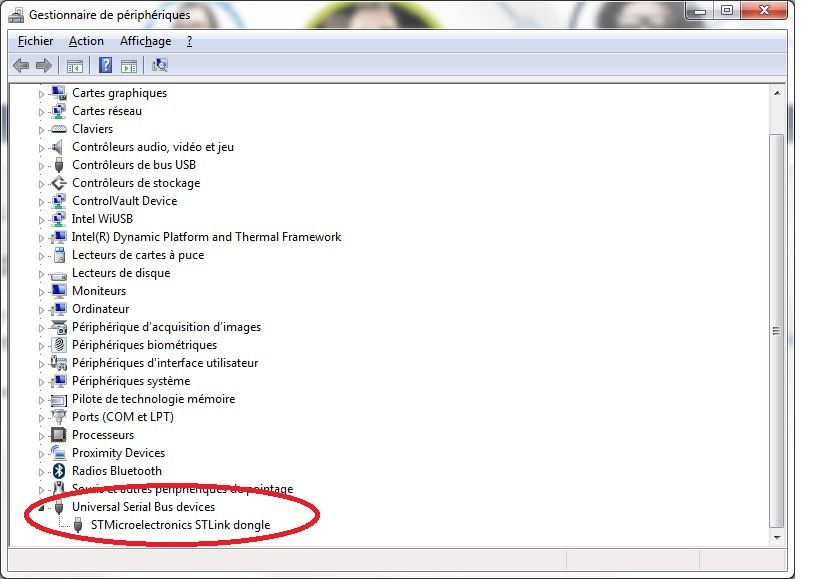

I have already tried to update the drivers multiple times without any luck. Here is a picture of my device manager, which does not seem to contain the ''STMicroelectronics STLink dongle'':

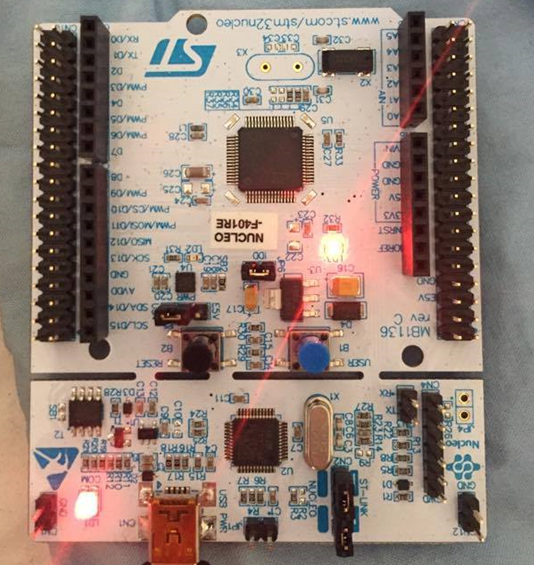

Also, here is an image of my board, if that can give any clearance:

ok kristian
the board you are using is including a STLink dongle the small part where you usb plug is (witch I call also probe sorry it's a direct translation of french word and may be not accurate) you can use it also for flash other boards but here it looks binded to the nucelo as describe here
anyway i think it's well known by windows under 'st link debug'
I sugest you to upgrade your probe (I checked it's the right word ) firmware by using this
(requiring a power off/on of your probe)and check your board documentation about the 2 jumpers on the right side of usb plug

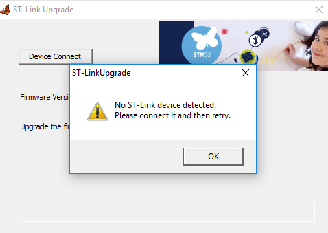

Thank you for your answer!

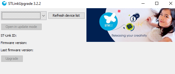

I am still having problems with the connection, and I still get the error message ''no st-link detected'' when i try to connect. I tried to upgrade my probe using the software that you linked, but that unfortunately had no effect. I tried both versions included, but got the following:
And with the other one, I simply get no device that I can choose, as seen here:
And there are no options in the dropdown menu.

from your photo above it's clear that the jumpers on ur nucleo are correct, so it's very strange that the 'probe' could be bricked like that. (i call it a 'loader' since it is more often used just to load your program into the microController chip). the reason the nucleo board has slots in it is so that the loader part of the board can optionally be broken off once the uC has been programmed. But whether you separate it or not, it can be used independently of the main part of the board (by changing the jumpers) as a 'dongle' to program other stm devices or boards.

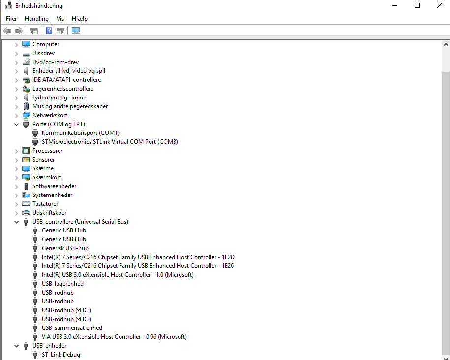

I take a look at my current Windows hardware configuraiton and confirmed identical to what you showed on June 21, for the STM relevant items.
