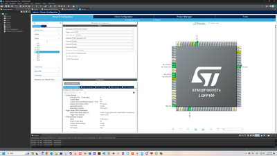

The MCU used is STM32F103VET6.
I want to use TIM3_CH1 (generating a PWM signal of 10kHz, 30% duty cycle) as the master input of TIM4_CH1. The TIM3 acts as the prescalar of TIM4 and thus making TIM4 to ouput a PWM signal of 200Hz and 60% duty cycle.
The below is my configuration of TIM4_CH1 in CubeMX and the code generated for initializing TIM3_CH1 and TIM4_CH1:

After that I just simple use the following codes:
HAL_TIM_PWM_Start(&htim3, TIM_CHANNEL_1);
HAL_TIM_PWM_Start(&htim4, TIM_CHANNEL_1);
The TIM3_CH1 did generated the desired waveform but no ouput waveform was found on the pin PB6, is it because there are some connections has to be made on hardware level? Or simply because I should not use HAL_TIM_PWM_Start for TIM4_CH1?
PS. The reason I'm not using the default PB12 as the output of TIM4_CH1 is that PB12 was assigned as the backlight of the on-board LCD, I can't use it conveniently.
