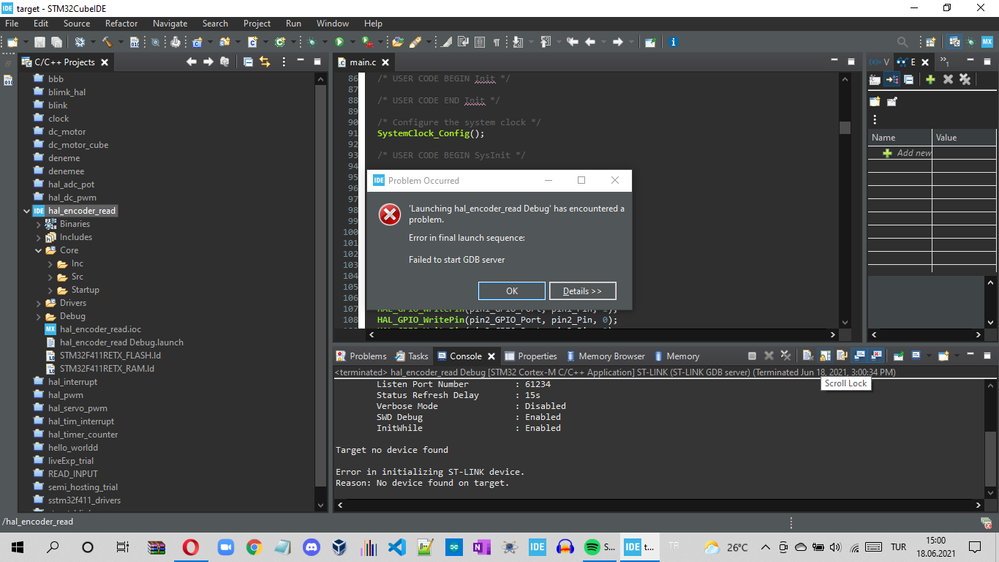

I used the Cube IDE with the latest version. Here is the screenshot
2021-06-18 8:14 AM
Hi @AYelb.1 ,
Maybe it's a jumper issue.
Check the pin connectivity following the schematic and check the BOOT0 if it is pulled HIGH.
