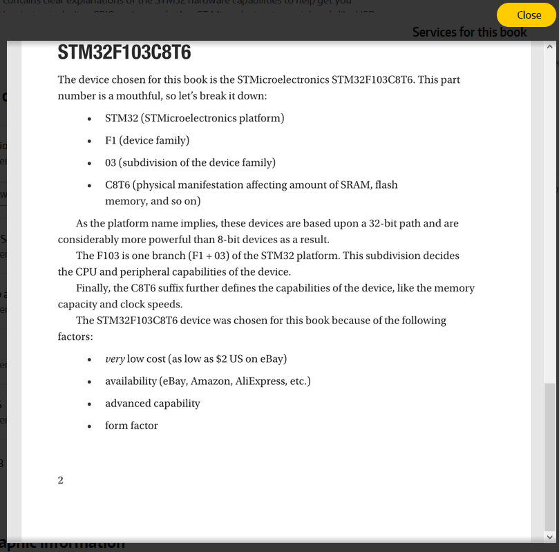

This book is exactly about STM32F103 (particularly useful for 2USD 'blue pill' board
2018-06-08 6:37 AM
https://www.cs.indiana.edu/~geobrown/book.pdf
http://www.st.com/en/embedded-software/stsw-stm32054.html
This is for the F2, but might be instructive
2018-06-08 6:53 AM
And a piece from the introductory chapter:
