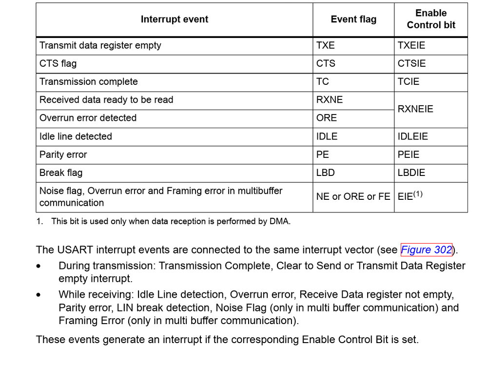

Question 1: Doesn't the uarts in STM32 has its own irq-vector for TX-register empty or is it USARTxx_IRQHandler() that deals with "TX-reg empty" and "RX irq"?

ad 1: 1 irq , when using callbacks you get automatic the one you want
ad 2: always called, when corresponding flag is set ("enable irq on event xx ")

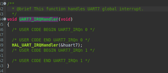

example:
in xx_it.c you get (generated by Cube):

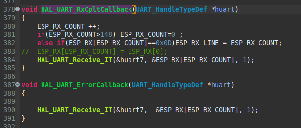

you can write there , in "user area" (begin .... end)
or use a callback (can enable call backs in Cube->project settings)

Yes. You confirm what I suspected. I'm already using RxClpt...
Yes. I will investigate the callbacks. They are disabled now.

Because HAL_UART_RxCpltCallback() dealing with both UART:s I need a if() that can distinguish between the two port-handles. �? have one buffer for each port with head/tail variables.
That should work I think.
