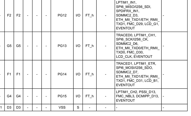

Agree seems LTDC isnt present in S3 MX config. Not clear why. And steps is use search on up.
S7 have example for LTDC , then maybe ... , but ST have bugs in systems...
When S3 not have then supported is 8080 displays... but datasheet show pins for LTDC then try use manual config

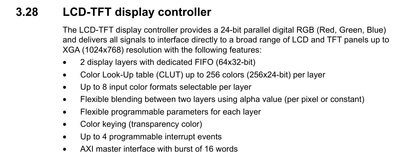

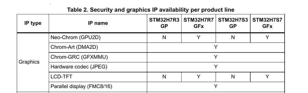

I searched for the LTDC ...in H7S , and from ds :
So H7S7 has LCD-TFT , H7S3 only FMC 8/16.
-> If 8 bit par interface is not working for your display, because need 24-bit parallel -> H7S7 needed.

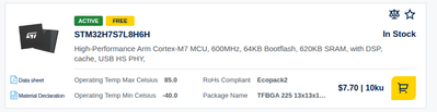

free sample avail:
