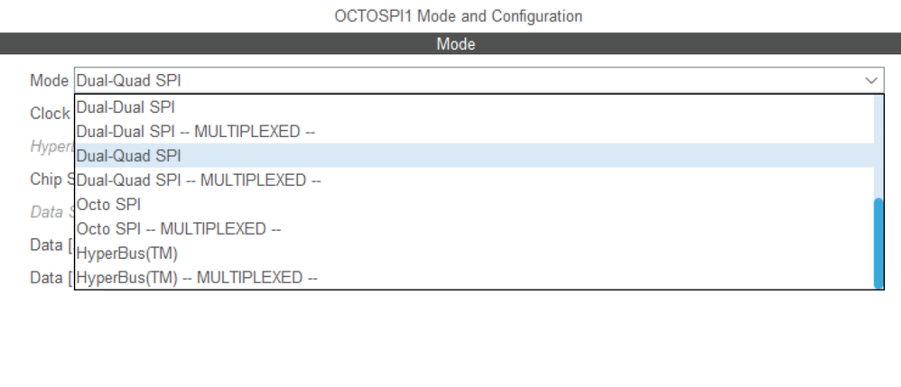

Yes. We have the 144-pin LQFP with SMPS, though we currently use the internal LDO.
It is not clear to me what mode I should use.
Dual quad or Octo? The MT25TL256 is basically two Quad dies in one package (twin quad) and not a true Octo chip. So I think I have to use Dual-Quad. Do I have to select multiplexed? In that case I don't have data pins 4:7.
My pinout is:
2023-01-09 8:10 AM
As long as you don't do fancy things, "Dual-Quad-SPI". Yes, it's essentially the same as two separate Quad-SPI chips, so eight data pins going to *ONE* OCTOSPI interface. CLK of both flash devices both connected to OCTOSPI CLK, the same for both NCS signals. Command and address would then go simultaneously to both chips, and only data would be interleaved between both devices.
"Multiplexed" would mean both chips together would be alternatingly connected to OCTOSPI1 and OCTOSPI2, that's rarely useful (except if access with different setups would be necessary without having to reconfigure the interface every now and then).

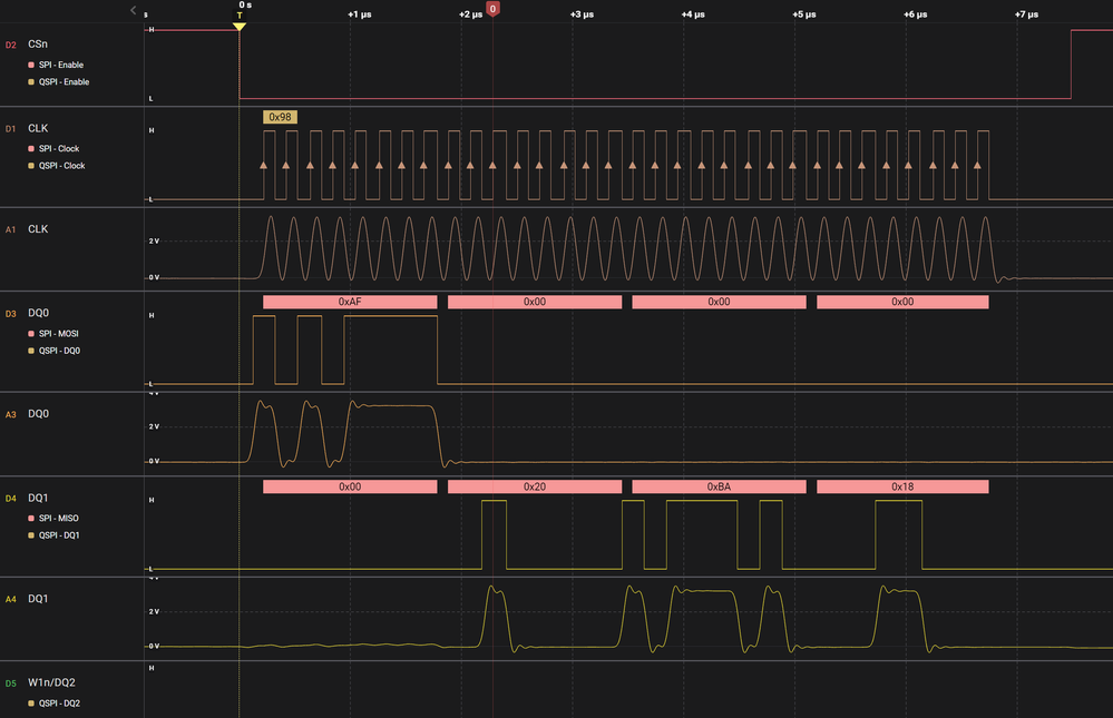

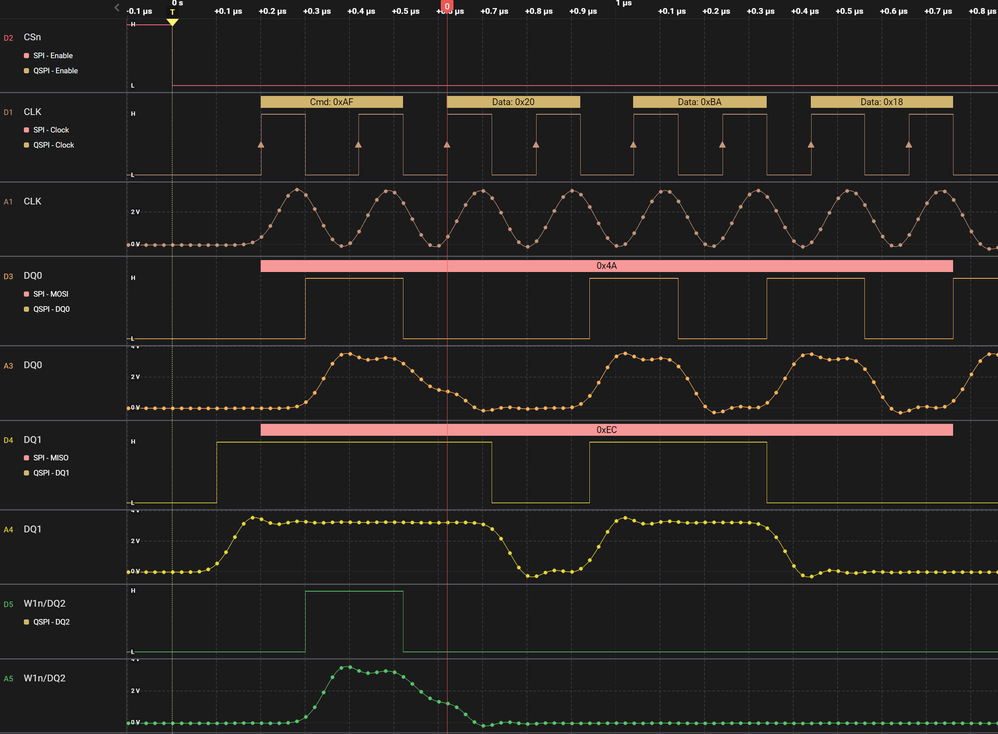

I'm making progress. I can initialize the part, read the id, and I also got erase and write working at some point. I'm now having an issue with reading the ID in quad mode. The first byte of the ID reads as 0x70 instead of 0x20. So bits 0 and bit 2 of the first nibble read as high instead of low.
I'm running the clock currently at 5MHz and sample it with a logic analyzer at 50MSPS.
Here are the logic charts.
As you can see the Logic Analyzer reads it correctly, but my MCU doesn't. The signal is clearly in the illegal zone during the rising edge. How do I fix this?
Edit: with half cycle delay or with delay block it seems to work. But it is not clear to me if delay block will work for all frequencies. Half delay cycle doesn't work with dtr.
2023-01-13 5:25 AM
I'm afraid that's a silicon bug, this appeared in this forum some time ago already (I don't recall whether this occurred with QSPI or OCTOSPI). The turn-around of IO2 and/or IO3 seems to be delayed, but as you noticed, SSHIFT solves this problem in SDR mode. Whether this problems occurs in DDR mode I don't know, but:
In general Read ID should be done in simplest mode only (1-line, SDR), as some flash chips don't support this command in e.g. 8-line mode at all (Adesto ATXP) or change the ID upon entering 4-line mode (Winbond). And most chips power up in 1-line SDR mode anyway, and to switch to any other mode, you have to know the type of flash chip already ...
For other read commands (read status, read register, read memory array) the dummy cycles silently hide this problem. (Yes, status read doesn't need dummy cycles, but most (all?) flash devices repeat status continuously, and this is the case for most registers, too, so one artificial dummy cycle won't harm.)
