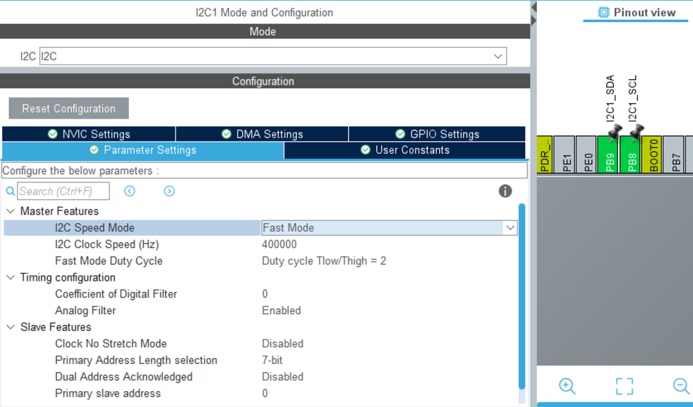

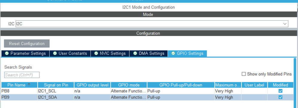

Hello @PReba.1,
First of all you need to set the configuration of the I2C for the communication based on STM32CubeMX :
Then generate The code.
The I2C address of the sensor : 0x18
Supply voltage : 1.6V - 3V6
Connect the 3V3, GND, SCL, SDA.
