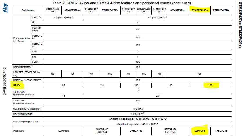

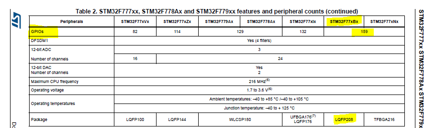

Question: In the data sheet of STM32F777BI Its mentioned that GPIO'S=159 in the page number 17,but in
STM32F429BI Its mentioned that GPIO'S=168 in page number 16,so what is the difference.
The above one is STM32F777BI,
The above one is

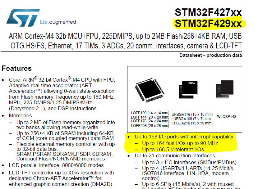

STM32F429BI,

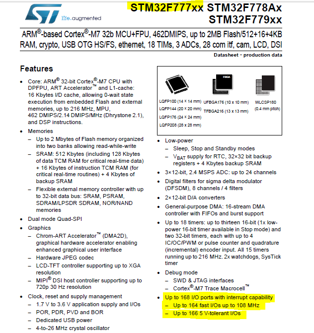

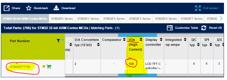

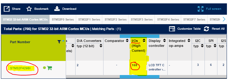

BUT in the front page of the datasheet -product description its mentioned i/o's 168 in both of the data sheet
and also in the ST.COM its mentioned i/o's 168 I/O'S

This seems to be imprecise/generic data in table 2 of STM32F77x datasheet.
The missing GPIOs are taken by the DSI interface on STM32F779 part numbers, so the value is not wrong actually.
The STM32F777 does not have the DSI interface and therefore has all the 168 GPIOs.
