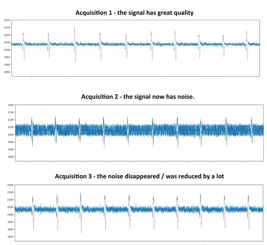

Generally, the quality of the collected signal is excellent. However, we've encountered an issue where the signal sporadically presents an unnatural baseline noise. This anomaly occurs irrespective of whether the data is being streamed via Bluetooth or stored on the SD card. After testing, we've deduced that the ADC is the likely source of the problem, as the noise appears and disappears when just starting and stopping acquisitions (without touching the device at all):
I started digging deeper into this, trying to remove variables out of the equation. The power-switch is now turned on at the device’s boot (i.e., it is not turned off nor turned on when starting / stopping acquisitions), we’ve removed the ADC calibration at the start of the acquisition, and the noise keeps appearing sometimes. The only thing we do at the start and stop of an acquisition is the following:

} On a final note, I have noticed that, if the signal has noise and we connect the EMG output / ADC input to ground, the noise disappears in the ground signal (and then that the noise returns to the EMG signal once we disconnect the ground). Can it be any impedance configuration of the ADC?
Do you have any idea of what might be causing this issue? Any suggestions on how to solve it?
