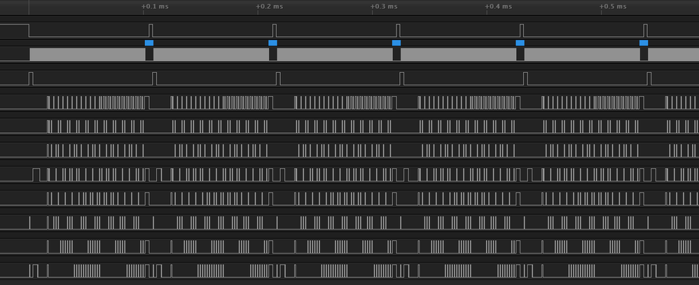

I ended up painstakingly tapping all the signals with a logic analyzer. The result looks like this (see below). I increased the clock divider to 20, so it's running at 1MHz now. It appears that the MCU is accessing the ram over and over. I think that might be it working as designed (pre-fething), but I'm not sure. The chip is definitely doing something, because the MCU does not lock up in it's absence, and the reads do not go on forever.

I would have thought that the chip needed the differential clock to work, but as there is data, it seems otherwise. One final thing: Have you tried the direct readout before mem-mapping? It might give at least some info on where the program crashes and depending on your debugger the possibility to check the registers involved at that step.

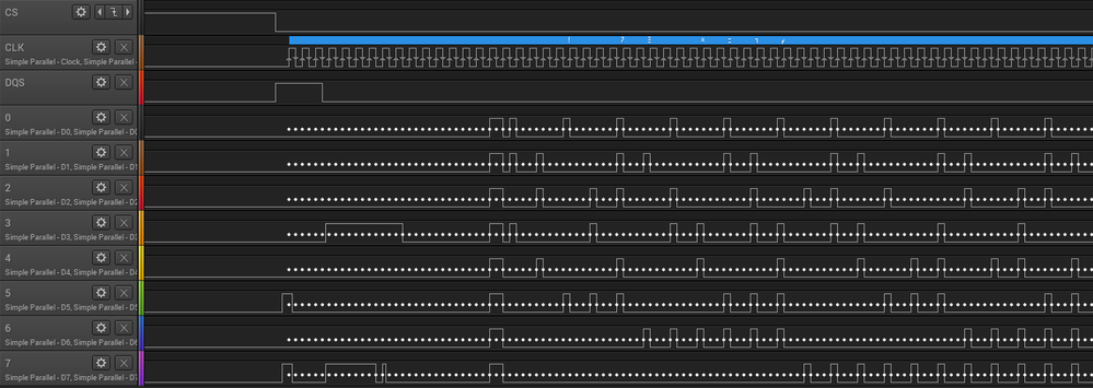

2021-11-04 2:25 PM
Thanks very much, I've been experimenting with this extensively.
When reading from the RAM in this way the chip no longer locks up every run! Now I can finally do some real debugging!
I can read address 0 of the register space, and I get a value close to what I was expecting (read 1000 1000 1000 0001, expected 0000 1100 1000 0001). But changing the address to 2 or greater gives the same result? I think maybe it's an electrical issue at this point? I've experimented with all the settings ad-nauseum, and the logic analyzer shows a command/address burst that looks correct.
