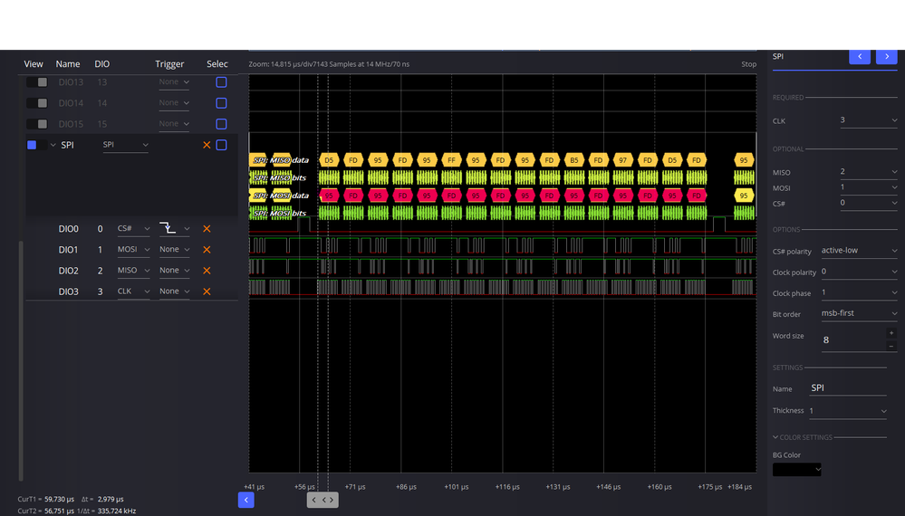

I am coming back to you because the my spi frame I am sending is not the same I am watching on the oscilloscope,

HAL_GPIO_WritePin(SPI3_CS_GPIO_Port, SPI3_CS_Pin, GPIO_PIN_SET);Could you please tell me we why I read 95 FD *16 instead of CA FA *16,

I don't know what the Cube configurations mean, but from the picture it's clear that you have set CPOL=0 and CPHA=0, i.e. SPI Mode 0.
Similarly, I have no idea what the settings on your analyzer mean - you should consult the analyzer's manual - but from what it indicates it appears that it samples on the second, downgoing edge, i.e. CPOL=0 but CPHA=1.

Your analyzer is probably set to different SPI mode (CPOL, CPHA) than the SPI in STM32.

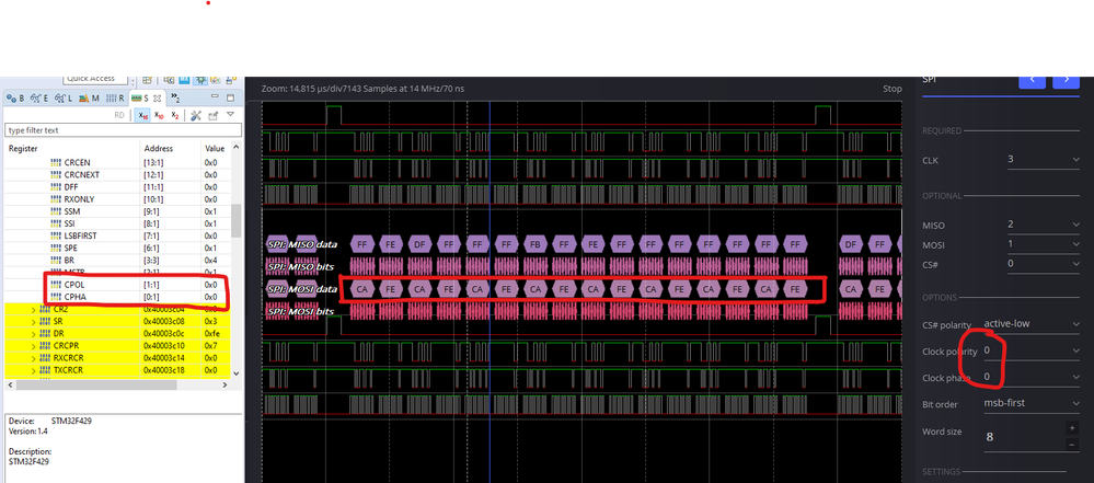

If you take a look to scopy picture, you could see clock polarity LOW, and clock phase = 1,
in the SPI configuration:
hspi3.Init.CLKPolarity = SPI_POLARITY_LOW;
hspi3.Init.CLKPhase = SPI_PHASE_1EDGE;Tarik

2020-10-19 5:35 AM
Your absolutely right,
I don't know what is the problem with CubeMx,
Any idea about this issue?
2020-10-19 6:50 AM
Why would there be any problem?
It's just question of definition. Instead of standard CPOL/CPHA notation, Cube authors decided for:
/** @defgroup SPI_Clock_Phase SPI Clock Phase
#define SPI_PHASE_1EDGE 0x00000000U
#define SPI_PHASE_2EDGE SPI_CR1_CPHAIf you use Cube, you have to learn both Cube's definitions and their meaning in RM.
