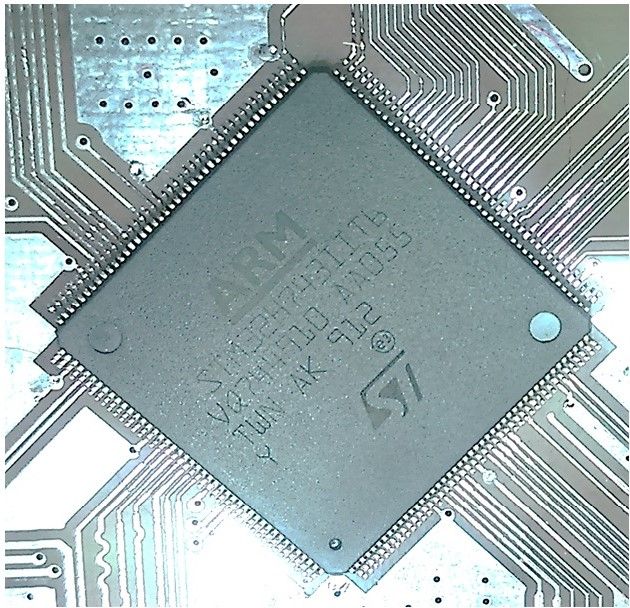

I looked with the scope on the signals at the input of ADC. Analog signal didn't have any problem
2020-01-11 9:52 AM
I think, it is RevY.

2020-01-11 12:04 PM
Thank you for introducing this link.
Base on this link,There is a problem in stm32h743 RevY and I have to migrate to stm32h743 RevV.
Unfortunately, stm32h743 RevV is not available to me and I can't test it.
Does anyone have any opinion about stm32h743 RevV?
