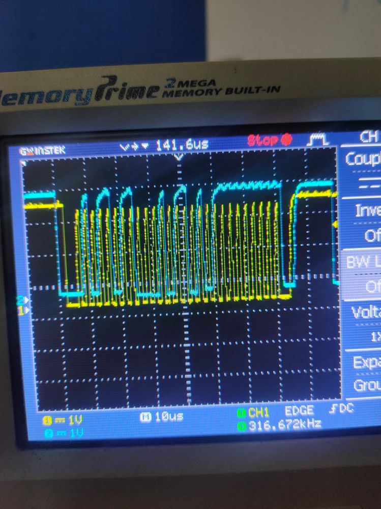

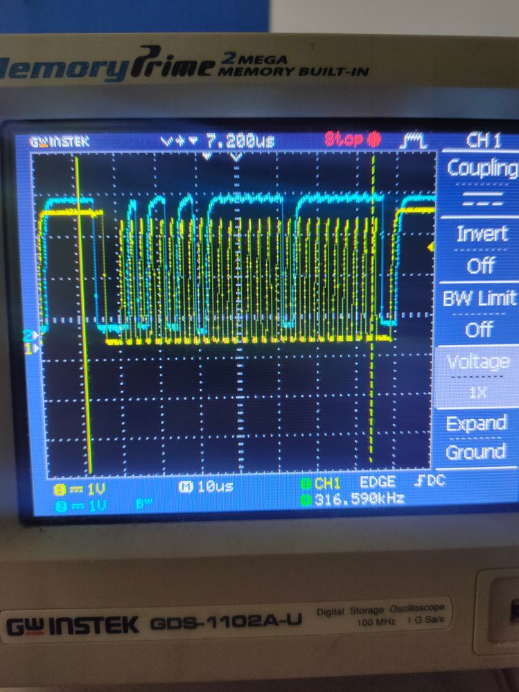

2020-09-16 4:57 AM
SDA and SCL lines- 1st image single data and 2nd image buffered data
