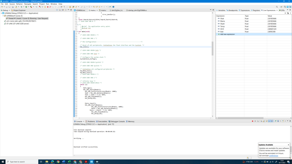

2023-11-16 7:37 AM
I am getting same values for all channels
