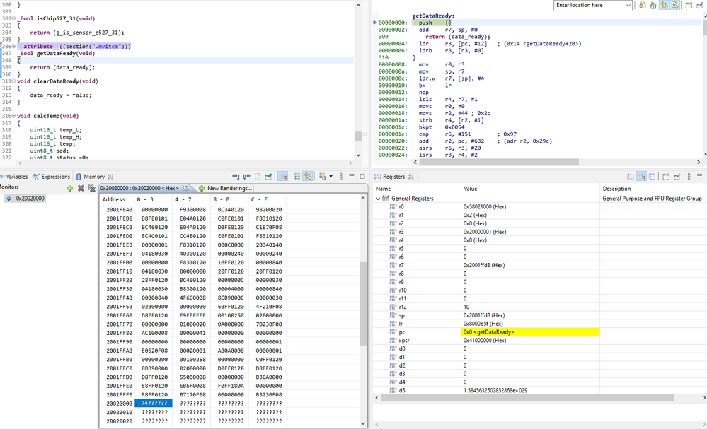

Should all functions which are called from the function moved to ITCM be located as well in ITCM?!
I tried to use very simple function for testing, just a function which returns one value without calling any function, it cases hard fault at the befgining of the function at instruction push{}

2021-04-15 6:21 AM
ICTM is located at 0x00000000 so if only one function is located in ITCM it will be located at the beginning which is not an odd address
you can find attached here some snapshoots which may help

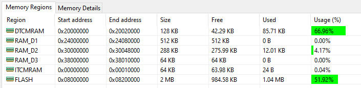

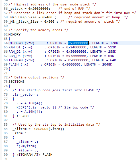

linker: the linker with memory layout and mapping of itcm section
ITCM_initalization1 & ITCM_initalization2 : code to intilize the ITCM RAM at start up
C_Function : c code for the function which is located in ITCM
Memory_regions : memory regions after linking
ITCMRAM : ITCM memory with function moved to it

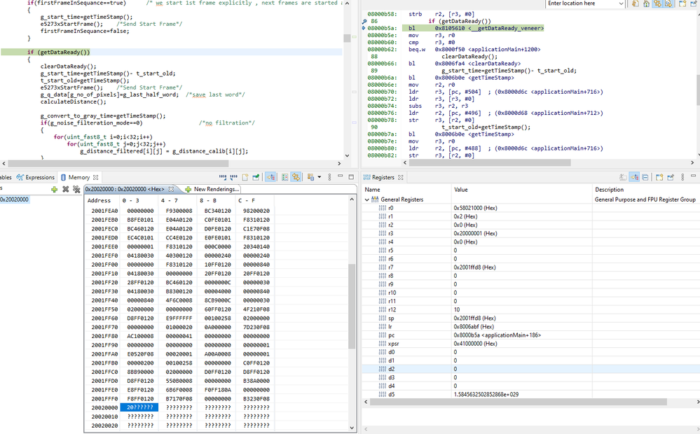

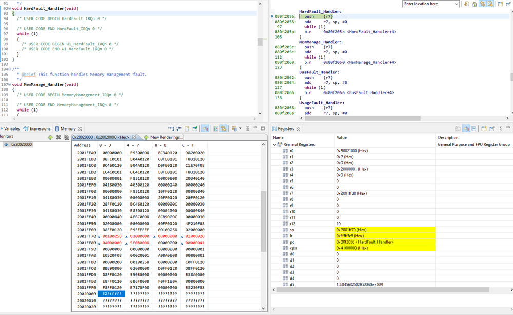

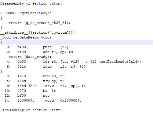

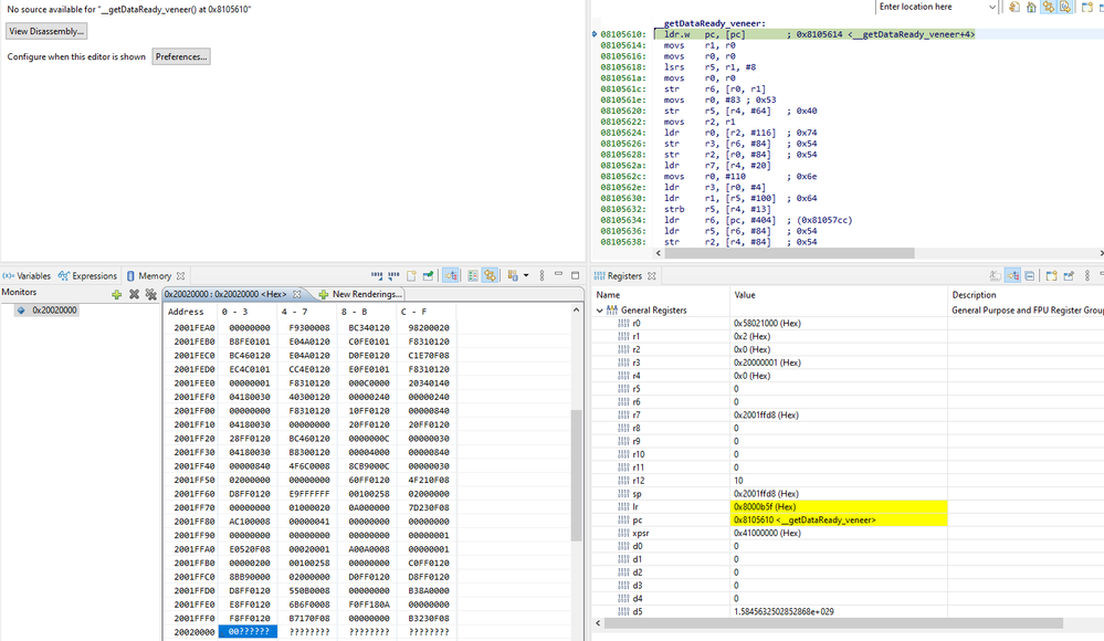

listfile1 : code from list file of code for calling the function located in ITCM
listfile2 : code from list file of the function located in ITCM
Debug1, Debug2, Debug3 and Debug4 : snapshoots for debugging from calling the function until hard fault with C, assembly , registers and stack shown .
4 snap shoots in next reply because system don't allow more pictures

2021-04-15 7:00 AM
The disassembly of the instruction at zero is not consistent with the code shown previously.
You really want to see the hex opcodes printed out in the disassembly listing.
Pretty sure push {nothing} is an illegal opcode.
2021-04-15 7:08 AM
This was my conclusion from the beginning.
push command pushes less registers than the required registers and if it's very simple function, push command pushes empty register list.
my question was and is why this happens and how to overcome this problem?
2021-04-15 7:19 AM
Look at what's moving the code into RAM, and what it's putting there. Cause it's not B480 / push {r7} which is what listfile2 claims it should be.
>>why this happens
&_sitcm is NOT ZERO!, fix the memcpy() to move aligned words, would be easier if the source could be cut-n-pasted
memcpy ((void *)((uint32_t)&_sitcm & ~1), (void *)((uint32_t)&_siitcm & ~1), (uint32_t)&_eitcm - (uint32_t)&_sitcm)); // and tilde one, font looks like a minus
Not exactly, pushing registers is not the problem here. The disassembly shows different code. Enable the hex codes if your tool permits that
2021-04-15 8:00 AM
Thanks
I found the cause of the problem.
a pointer to string is used to update the string , the null case of this pointer was not handled which caued writing to address 00 which corrupt the Push instruction.
