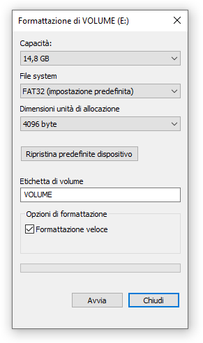

Try to summarize: I have problems with 16's and 32's of GB SD Card.
I formatted the 16's of GB SD Card with FAT32 and 4096 cluster size:
The block size in the stm32f7xx_hal_sd.h is 512:
#define BLOCKSIZE 512U /*!< Block size is 512 bytes */but when I insert the SD Card and try to mount it, the operation fails as described in the main question.
