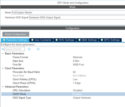

I configured SPI in the IOC to :
Full-duplex Master
Hardware NSS Output Signal
PB0 as SPI1_NSS, PE13 as SPI1_CLK, PE14 as SPI1_MISO, PE15 as SPI_MOSI
with the below parameters :
