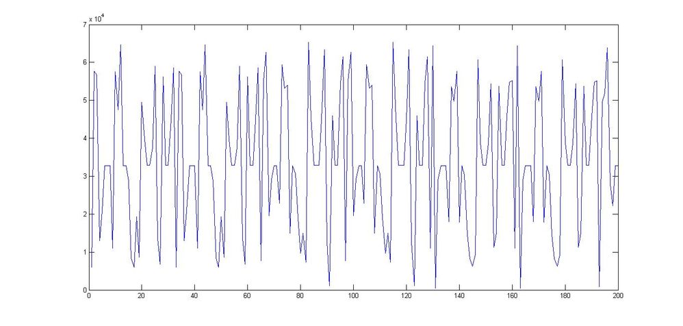

I am working on extracting the data from the MP45DT I used PDM filter function. I gave a beep sound to the microphone in the certain frequency, but I noticed that the captured raw data is not given as a sine wave.

2015-06-09 10:24 AM
Is the data really UNSIGNED 16-bit? If not think about how two-complement data might plot on a 0-70000 scale...
2015-06-09 11:49 AM
Thanks for the reply clive1,
Yes the output data after go through the filter is Unsigned 16. I collected each 32 samples after interrupt of the DMA double buffer and put it in one array and plotted it. But as you see from the graph, the wave form is quite weird. I dont know if my settings are wrong or not . Supposedly we should expect some kind of sine wave right, if we emit sound in certain frequency to the microphone?2015-06-09 12:22 PM
Yes, and to which I suggested that you consider if this is actually UNSIGNED data. I doubt that it is, plot it as SIGNED data in the +32767 to -32768 range.2015-06-09 5:06 PM

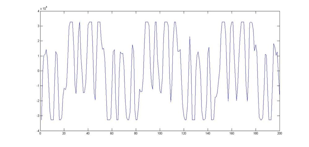

Thanks Clive1
I do the casting for converting the unsigned 16-Bit to signed 16-Bit. Is it correct?void DMA1_Stream3_IRQHandler(void)

And this the best possible plotting I got.
