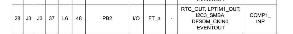

Are you using PB2 for LPTIM2?!
PB2 can only be mapped to LPTIM1_OUT not for LPTIM2_OUT!
Try PA4, PA8 and PD13 for LPTIM2.
Please take a look at Datasheet, it's always healthy to check it.

Thanks for clarifying the limitations on LPTIM2 output. As you suspected, I was trying to do something impossible. I had downloaded all the documentation from the STM32L476G-EVAL product page, and had the STM32L4x6 Reference Manual but not the specific datasheet for the STM32L476xx, so I was missing information on LPTIM2_OUT. I was able to get the LPTIM2 demo to work outputting to PA4 without a problem, confirming the pulse with a logic analyzer.
