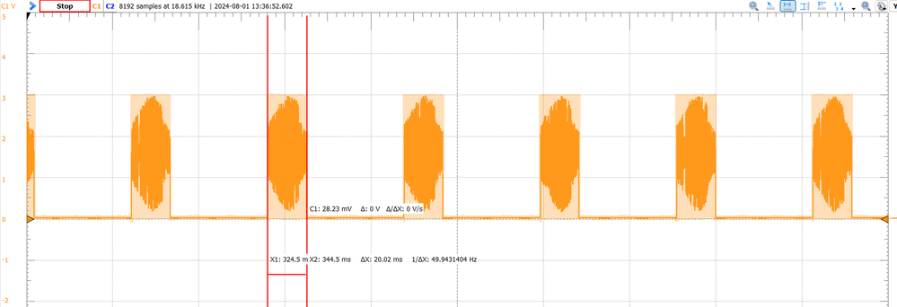

I'm relativ new in working with Nucleo Boards and currently working on a Project where i want to generate a chirp signal/sinus sweep from -20kHz up to 20kHz.I made myself the following table in excel to have all the values.

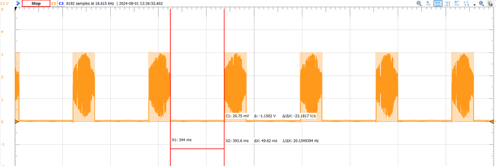

With a Clock Frequency of 100MHz, a Prescaler of 17-1 and a Counter Period of 100-1 i got a pulse length of ~20ms which is exactly what i need. The next step i want to achieve is a 80ms pause between each pulse. No matter what i write into the HAL_delay() the pause inbetween pulses wont change. Even without the HAL_delay it is ~50ms.

Yes its on circular. And if you add the pause between the signals up you have 20ms for signal, 50ms pause adds up to 70ms period. Currently i have no clue where the pause comes from. Which is also the reason why i made this post. I've tried to extend the pause with a delay, but it wont change anything.
