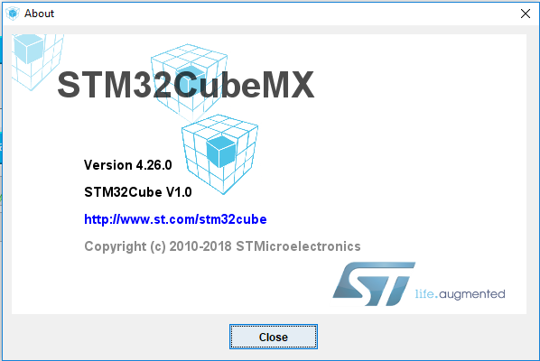

Hi
greenwood.greg
,Are you using the most updated version of STM32CubeMX tool (4.0)?
Khouloud.
