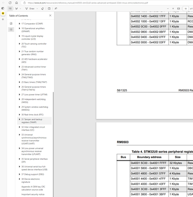

4. Usually each section name ends with an abbreviated name in parenthesis. Ex: Low-power universal asynchronous receiver transmitter (LPUART). And this abbreviated name is also in bookmarks on the left size of each RM. But (LPUART) is not in bookmarks in several RM possible all from the beginning.

All those issues have been escalated for correction under internal ticket number 180725. Thank you so much for your help. For the name on the bookmarks, it seems to be fine on my side:

And now the bookmarks is ok.

And now there is a problem with the bookmarks or by default they are expanded. In any case this should be fixed.
