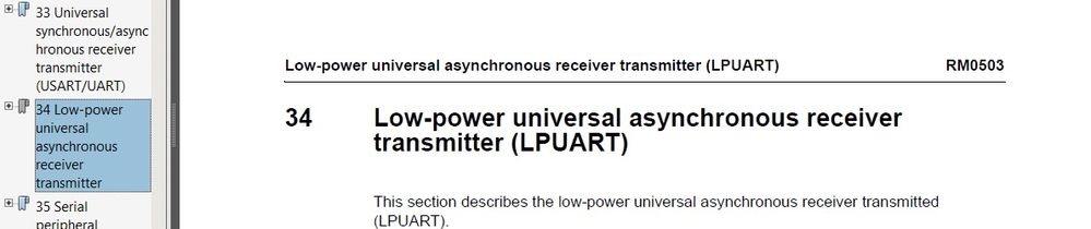

4. Usually each section name ends with an abbreviated name in parenthesis. Ex: Low-power universal asynchronous receiver transmitter (LPUART). And this abbreviated name is also in bookmarks on the left size of each RM. But (LPUART) is not in bookmarks in several RM possible all from the beginning.

The blue text on the left should also end with (LPUART). I know this is insignificant and I just talked about this because I wrote this post due to other things.

I think you don't understand. The problem is only the section name in bookmarks and not the section in the doc. The section "34 Low-power universal asynchronous receiver transmitter (LPUART)" is in Rev. 2 of the doc. The section name in bookmarks is: "34 Low-power universal asynchronous receiver transmitter". And should be: "34 Low-power universal asynchronous receiver transmitter (LPUART)" to be like the others.
