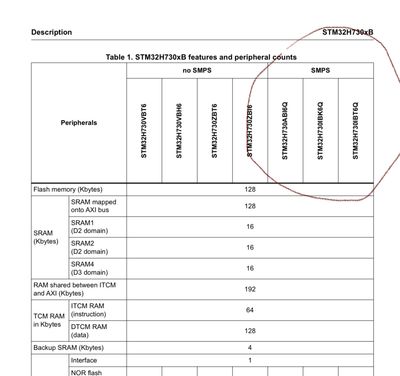

The letter q means the device supports the SMPS configuration. Please refer to the device datasheet:
The reference manual covers both devices: with and without SMPS.
Need to check what part number you have: SMPS or not.
