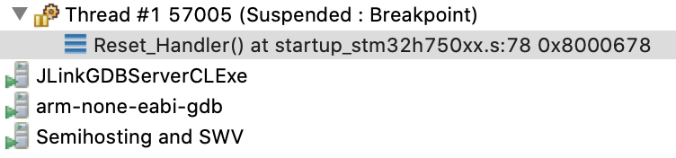

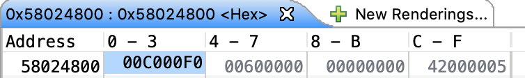

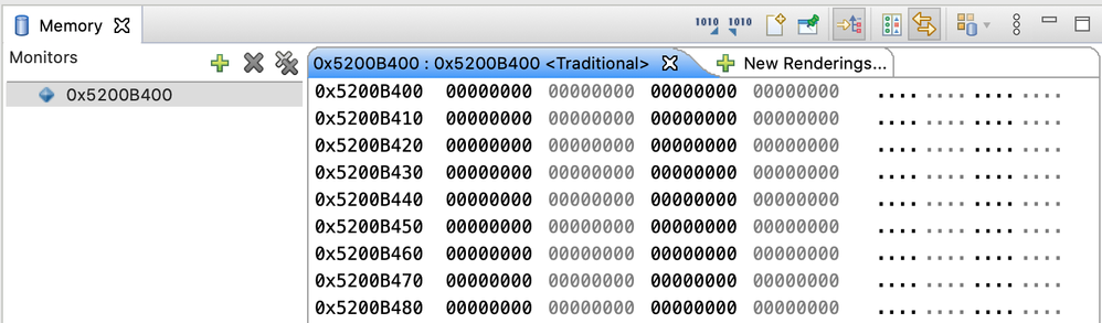

} OCTOSPIM_TypeDef;Connecting a debugger, halting the CPU in the Reset_Handler before any code runs and inspecting the memory at the location results in the following:
Expected default values:
I'm unable to configure the OCTOSPIM peripheral on at least two CPUs.
1) STM32H730VBH6
2) STM32H730VBT6
I have two designs, one using the STM32H730VBH6 which uses OCTOSPIM data lines 0-3. The default configuration for the OCTOSPIM device allows it to work just fine.
The second design, using an STM32H730VBT6 uses OCTOSPIM data lines 4-7 for the flash chip and thus requires non-default configuration.
I verified the problem on BOTH designs. Any attempt to write or read to the OCTOSPIM periphal has NO EFFECT on both designs. Multiple PCBs built, all silicon has the same issue.
I *am* able to read other non-zero reset values using the debugger and other code, such as the defaults for the PWR control register 1.
Questions:
1) Is the base address correct?
2) Is the silicon bad?
3) Why is the length of OCTOSPIM_TypeDef->PCR et to 3, in the HAL code. When there are only TWO PCR registers.
4) What's the solution/workaround?

2021-04-21 5:34 AM
Success!
Thanks a million for point me at that register, I doubt I would ever have found it.
The workaround/solution is:
RCC->AHB3ENR |= RCC_AHB3ENR_IOMNGREN;
if (HAL_OSPIM_Config(&hospi1, &sOspiManagerCfg, HAL_OSPI_TIMEOUT_DEFAULT_VALUE) != HAL_OK)This issue highlights that:

2021-04-21 4:25 AM
2021-04-21 5:16 AM

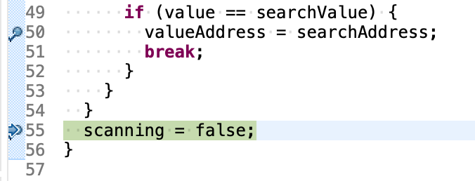

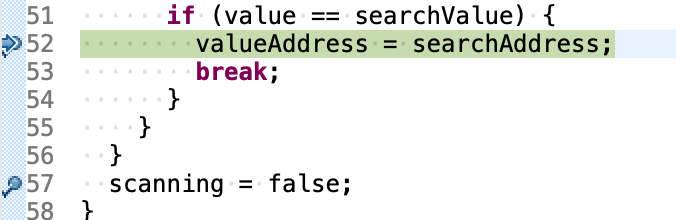

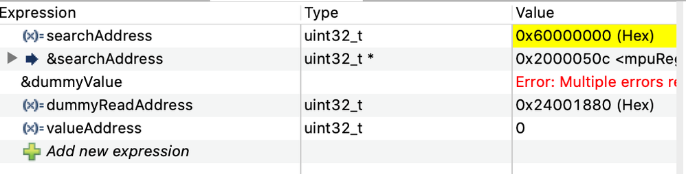

Further to this I created a tool to scan the entire peripheral address space for known peripheral register addresses.
https://gist.github.com/hydra/f2cffb9e590ec7a203c0ff3b6462c051
The tool does *NOT* find the value for the OCTOSPIM_P1CR or OCTOSPIM_P2CR in the documented peripheral address space.
In these screenshots the breakpoint is at the end of the scan, the searchAddress reached the end of the peripheral address space.
Given this, I currently conclude that the OCTOSPIM peripheral cannot be accessed in the MCU and that there's a silicon bug.
