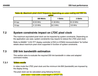

Hello @MM..1 ,
What is the pixel clock frequency you used?
Please refer to AN4860 precisely section 7 DSI host performance and check the maximum pixel clock frequency depending on color coding and DSI link speed.
May AN4861 can help you.
Are you used video mode or command mode?
Thank you.

We test 40MHZ for around 45Hz framerate on this resolution and 960Mbit data speed 24bit video burst mode.
We ask for solve quick when somebody have this controller run with STM. But yes is on edge 1Gbit capacity. We plan switch to 16bit and make more tests. Any info is invited.
