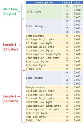

At the moment I create a binary file and start the file with the UNIX time, followed by samples (each 14 bytes in length) until the data log is completed.
Each sample consists of a 4-byte tick time and 10-bytes of serial data received via the UART (at a 100ms rate):
The diagram below shows the structure of the binary file, with just 4 samples for simplicity. The number of samples for a real data log would obviously be much higher than could fill the entire SD card.

I am sending UART data (using Realterm) which will be written as a binary file to the SD card.
The file structure is as follows:
I send 585 'samples' using Realterm which is 8190 bytes for each send (i.e. 585 x 14).
Note: In the real application, the 10 bytes of UART data is transmitted at a 100ms rate. But for debugging purposes I use Realterm to send all 8190 bytes transmitted in one go.
The UART interrupt is configured to receive 10 bytes, during this interrupt the time 'stamp' is incremented and a data received flag is set...
