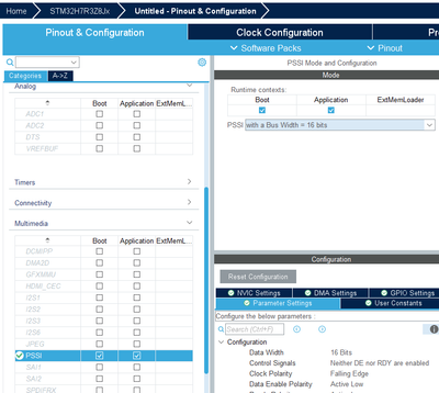

Hello @FA1234 and welcome to the Community :)
Make sure to download and use the latest release of STM32CubeMX (version 6.12.0).
I checked your use case (with STM32H7R3Z8 device) and enabled the PSSI without issue.
You can enable the PSSI. Then set the PSSI parameters (select a 16-bit interface, hardware control signals...) from the PSSI Mode Configuration Menu.

It turned out I did not have the H7LS package installed, but only the H7. The result was that PSSI wasn't enable-able! After installing, all worked fine. Thanks for the quick help!
