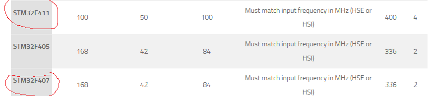

We have an application already running properly on STM32F411 which runs at 100mhz.
When running it on STM32F405 which runs at 168mhz, there are issues e.g., COM port connection to PC etc.
Seems this is the difference between 100mhz and 168mhz.
See https://stm32f4-discovery.net/2015/01/properly-set-clock-speed-stm32f4xx-devices/
Any pointers and advice on what should be tuned and how would be much appreciated.
(please note... It's the first time I'm doing such tweaks related to clock speed...)
